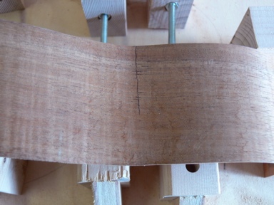

I successfully repaired a crack in the waist of a side with CA, but now I am left with a dark line of CA. Is there anything that will dissolve the CA near the surface, and some technique that will hide the glue line?

PostPosted: Sat Aug 11, 2007 2:56 am
Nothing I can think of, sorry!
Visiblity is one reason to use hide glue (hot) for crack repairs in non-dark woods (in a dark set of EIR, it doesn't much matter...)
PostPosted: Sat Aug 11, 2007 3:09 am
Acetone will dissolve CA, but I would test on scrap and wait till others chime in, there may be better way.

Hi
what is making it dark? is it dirt in the crack? the ca we use dries pretty clear.
sounds like one of those fun jobs where you get to scratch all your glue out of the repair you did, clean it out and re-do it!

Unfortunately, my crack will be very visible.  I used clear CA so I don't know why its so dark.

[QUOTE=Mattia Valente]Nothing I can think of, sorry!
Visiblity is one reason to use hide glue (hot) for crack repairs in non-dark woods (in a dark set of EIR, it doesn't much matter...)[/QUOTE]
Do you mix dust with the glue?  Is hot hide glue the only glue that won't be darker than the wood?

PostPosted: Sat Aug 11, 2007 4:28 am
Posts: 2060
It's possible that the crack was not fully closed and you're seeing the gap
which would appear dark, even if slight. If the crack were fully closed it
should not appear too dark after it was sanded unless it was a low viscosity
CA that really saturated in to the wood around it. If this were the case then
you are seeing darker wood there because it is essentially finished. Wipe
some naptha on the side to see what the finished color will be - it's quite
possible that the darkness will at least come close to matching the rest of
the wood when it is finished.

I wiped paint thinner on it and the crack was darker.  So it seems if there were a way I could dig out the CA then I could fill it with something that would match?

PostPosted: Sat Aug 11, 2007 4:48 am
Posts: 2060
That's a tough one, and unfortunately I think with out some seriously
delicate patchwork it's not going to go away.
I doubt very much that you're seeing any actual dark substance within
the crack, but rather the lack of substance. Even a small gap when filled
with something clear like CA will appear darker, simply by the light (or
rather lack thereof) refracted through the fill. If your sides are thin
enough I would bet that the crack would actually look lighter than the
finished wood with a decent powered light source behind it.
I hate to say it, but the easiest way by far to get rid of the crack is by
getting rid of the side. If you're building this instrument to sell, then I
would also say it is the cheapest way to fix it after figuring in the cost of
your time. It looks like a compression fracture, and unlike a break on the
outside of of a bend those will never go away.
I say scrap it and move on with a new set of sides. You'll be much
happier when the instrument is done.

Alas, I hate to admit that you are right, but you probably are.  I'll get new sides and move on.  Thanks David!

I guess I shouldn't have said "scrap it", but rather sunburst the burst the
back and sides. Shading is a beautiful thing, and is a wonderful age old tool
of hiding defects. If you don't want to burst this one then set it aside for a
future project.

Beautifull Koa... worth trying to save I'd say.

Joe, that was my thought.  Maybe I too will be a converter of big boards into smaller!

I cleaned out the dark stuff from the crack.  I have varying colors of koa dust.  Which glue should I use to mix it with?

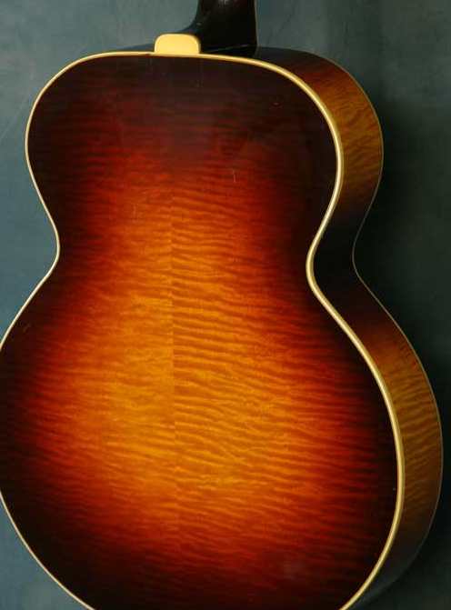

Really though, I would burst it in a heartbeat. Why do you think bursts
became as popular with manufacturers as they did? A natural finish is
certainly easier to do in theory, but a burst allows for so much room
for error throughout the whole building process without any visible effect
on the finished product. It's a beautiful thing......

I thought David's first wordless entry here was just perfect. 'Burst it.
The more you try to hide that, the more visible it's going to get, and no amount of koa dust, pixie dust, or star dust is going to make that crack disappear under a clear finish. Put a strip of fabric or a spruce pillar behind it.
I've seen some very high dollar luthiers' work fixed and bursted around here... Yes, cross grain cracks in flame figured woods fixed with superglue. The work of probably three dozen luthiers comes through our spray booth here in a year's time, and everybody...and I mean everybody has trouble with koa or flamed maple from time to time.   Structurally it's probably stronger after it's fixed and backed up!

David BTW, beautiful sunburst job!!

[QUOTE=Ricardo] David BTW, beautiful sunburst job!![/QUOTE]
Thanks, I actually did that burst in one of my previous lives when I was
working back in Kalamazoo.
That was a shot of a 40's Gibson L-5, not mine.

PostPosted: Sat Aug 11, 2007 8:15 am

PostPosted: Sat Aug 11, 2007 8:37 am
Posts: 1398
I'm not David, but who cares if it's unusual. That makes it worth more.
Actually, we burst koa and it's drop dead beautiful. I'll do a kind of "tobacco 'burst" with just US Cellulose "Warm Brown" and "Van Dyke Brown" MEK stains straight on the wood. To go more opaque, you can shoot the stuff onto tacky sealer or mix it in with the finish of your choice. On that one I'd do the wood stained burst first, and then hit the sealer coat to go really dark in the waist, etc. It's kind of a hybrid 'bust techinque.
